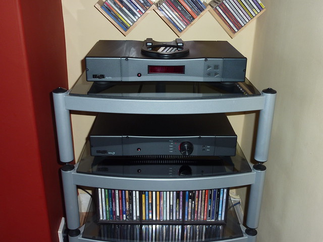

My set up is a recently put together Rega system, Rega Apollo cd player, Rega Mira 3 amp and Rega RS3 speakers. Interconnects are Atlas Equator II and the speaker cable is Van Damme studio blue.

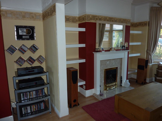

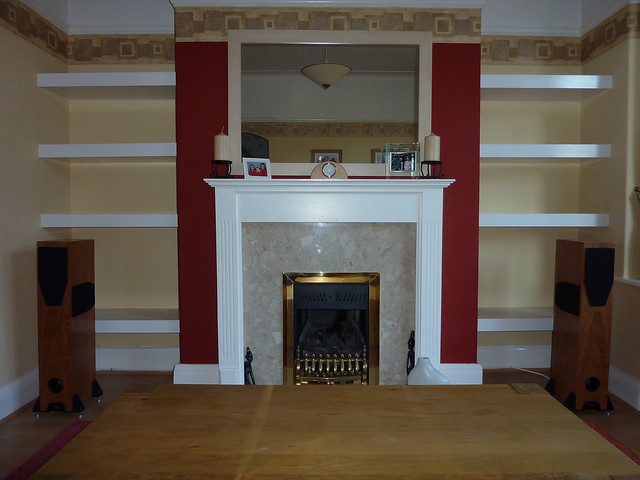

Ah man that looks like such a nice setup and listening room! I can imagine at night with the lights turned down and the fire going it must be so relaxing! do you not toe your speakers in? Sorry to hear ya having probs, have you contacted the peeps that sold you the setup or did you buy it all from different suppliers?

Nice looking room, though personally I'd move your speakers so that the left one is at least flush with that partition next to it so it is firing into space.
