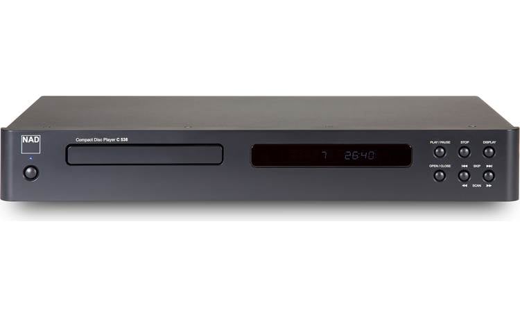

Just to make sure, the whirring and clicking sounds are coming from the CD player, not the amp?
If that is a question for us then surely you are in the best position to answer it, not us.
Is the sound emanating from the speakers or is it a mechanical sound from the player itself?
You keep asking the same question .... NOBODY on here can answer that .... they haven't heard it and unless they have they can't comment.
Even if they have they won't be able to diagnose it unless they compare it with another system or a replacement of one of the problematic CD's.
You need to test one of the ways I've suggested above, there's NO other way to tell what the cause is.

It's coming from the player itself.
You have been given very sound advice by a variety of members. Even an optical drive in a laptop or PC will identify whether the issue is with the player or the discs. Please do what you can to access another spinner before pulling the trigger on replacement CDs or a player and report back with your findings.

Okay, update!!
I tested the CDs on an old Sony SS EC69i. Basically an older, cheap stereo.
The problem CDs DID cause the same problems on this stereo. However, they were not as loud.

Okay, update!!
I think you have found the root cause of your problem - the CDs, which is very strange indeed. If you get the chance to try them in a better quality player then do so. Or as someone previously said on here, if possible copy the CDs and try the copies on your player.
Is it possible the problematic CDs might be unbalanced? I read about this on another forum.
I want to be able to directly use the CDs. I guess my only options are to buy new ones from a different pressing, or find a CD player so quiet you can't hear them.
Yes, they can be unbalanced but the only time I have ever encountered this issue is when ripping CDs as the disc is spinning at far higher speeds than a CD player. However, if your CDs were that unbalanced surely the noise you are hearing would last longer than 8 seconds. I believe CDs are played from the centre outwards which means they are spinning at a much lower speed at the start than at the end...this perhaps blows a hole in the unbalanced theory.
You have three options left:
Put up with the noise.
Purchase a different pressing in the hope it plays quietly.
Rip, copy and burn the problem CD to another disc.
Do not purchase another CDP as you'll be wasting your money...you have proven the CDs are at fault, not the player. However, if I had the chance I would try them in a good quality player.
Edit: just a thought, are the CDs warped?
They aren't warped.
I noticed on the other stereo there was less noise, but yes, it seems the CDs are at fault.

They aren't warped.
Do you have a computer with a drive you can RIP a copy to ... or a friend that can for you?
If not, do you know anyone that may have a copy of any of the ones that are bad .... last resort buy a copy of the one that's worst and see what it sounds like in comparison .
