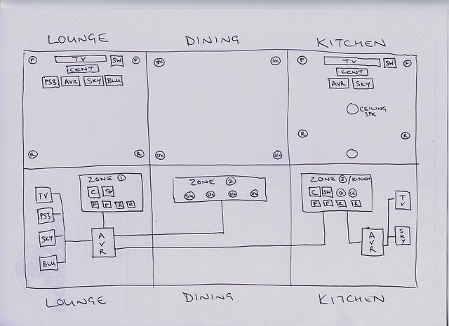

Can I upload a diagram anywhere of my intended set-up in each of the three rooms? And how I think everything joins up if I understand all the advice correctly?

Hi
I have uploaded a plan to flickr. Is this possible?
Also, where do ceiling speakers fit into a surround sound set-up?

Hi JD,
Did you manage to find anything that might be applicable to my plans? I think you mentioned an old Yamaha model?
If it really is an unrealistic plan if not impossible I'll focus on keeping the kitchen area separate and having the two zone Lounge and Dining Room.
rik
