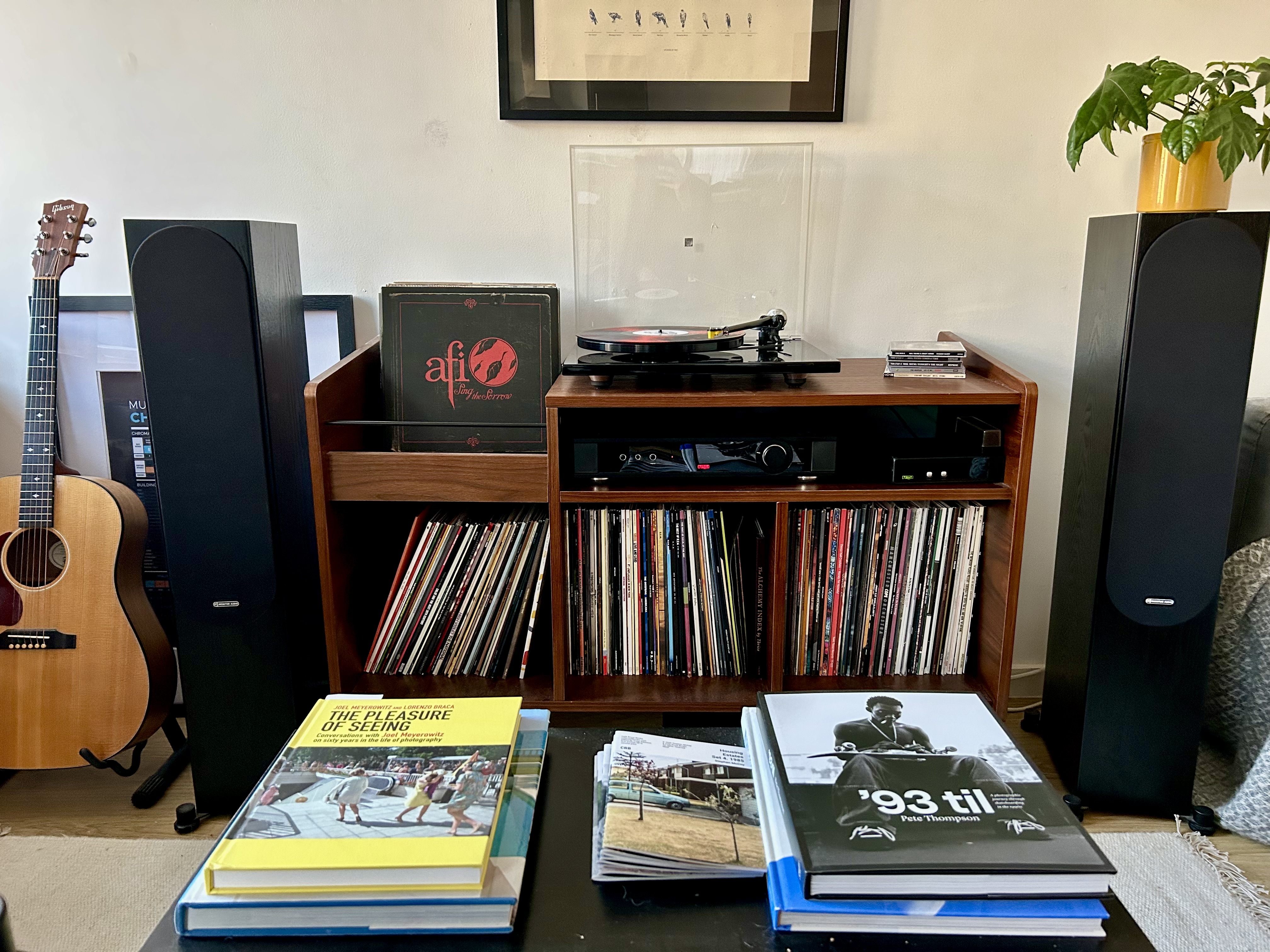

A few hours into listening. Might be my ears but the sound seems fuller through the speakers & the crisp treble is even crisper. Hi-hat taps are a joy to listen to.
Thereā€™s still some noise with nothing playing, but Iā€™ve got to go over halfway before it becomes really noticeable. And Iā€™m never likely to push the amp that hard.
Really surprised about how much nicer this sounds with more bottom end & extra clarity on high end.

Delighted that the P6 is making you smile, that is what it is all about, enjoy every note that you hear.
A question if I may; what are those speakers I can't quite make the brand out when I zoom in, and is that your set-up with the speakers seemingly pretty close to the wall, it clearly isn't doing any harm to the sound as you're enjoying what you're hearing.
The reason for my question; whilst my ATC's are excellent I am concerned that my little Hegel hasn't got sufficient grunt to drive them as well as they need to be driven (60W v recommended 75W+) so am contemplating something new that could work close (ish) to the rear wall.

Thanks, just put Michael Kiwanuka on & am hearing new detail in the tracks. This is going to send me on a whole additional adventure through the back catalogue šŸ˜Š
The speakers are monitor audio silver 300. Theyā€™re about 20cm from the wall, never had a problem with the bass (until now). Did just have to port them, seems this cart has a much higher output.

I would suggest those speakers are way too close to the turntable and it needs to be on some sort of isolation platform or better still wall-mounted
Revolutions
Appreciate the suggestion- unfortunately thereā€™s a sofa next to the speaker. Iā€™m lucky to have space for that unit but itā€™s wedged in on both sides. Maybe Iā€™ll move the turntable to the left.
And Iā€™ll look at isolation platforms, I have been known to skip a record with a heavy misstep on loose floorboards,

ā€œThereā€™s still some noise with nothing playing, but Iā€™ve got to go over halfway before it becomes really noticeable.ā€
Maybe the proximity of the turntable to the speakers is causing the issue? Just a thought.
Reactions: Revolutions
I think it more likely to be hum induced by being placed above an amplifier.
Easy to check by lifting the deck carefully (obviously within the limits of the cables) while listening to the background noise.
If there was feedback during loud replay then I agree I would suspect the RH speaker was too close.
A wall mounted shelf will serve both to create a greater distance from the amp below and protect from footfall vibrations.

@al hereā€™s a little update. Noise floor slightly improved with volume right up & nothing playing. No other significant change, except that looking at it makes me dizzy as layout feels off balance. Iā€™m sure that will fix itself with time. Still really happy with the extra beef & treble itā€™s given the setup šŸ˜Š

I also have an RP6 turntable (using with Monitor Audio Silver 300's - 6th gen) and when I first got it, it hummed badly at relatively low volume. It was back and forth to the shop I bought it from many times without a solution. I positioned it in all sorts of ways but it still buzzed. Frustrated, I took it to an independent hi-fi repair shop and he told me this...
"Your arm cable shield is broken at the exit from the arm post and that is causing horrendous noise in one channel and some also in the other when the cable moves."
The good news for me is that he fixed it quite cheaply.
Do a Google search for "Rega" and "buzz or hum" and I bet you get more than a handful of results.
