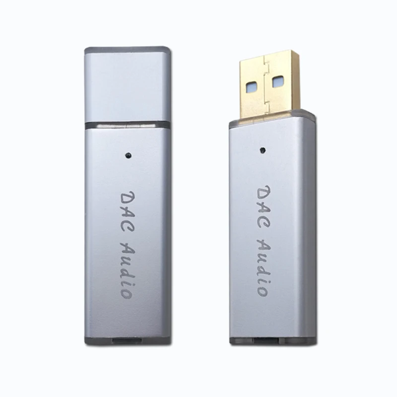

3. Should I be using a seperate DAC? Would it improve / alter the sound compared to the current connection?

1. Is there a noticable difference between the built in sound and dedicated sound cards
With newer motherboards no. Not unless you need a headphone amplifier in which case an audiophile grade card such as the Asus STX/STX II or the new EVGA Nu series makes sense. They'll also offer gaming and entertainment modes. For pure music you might want a discreet amp/DAC or amp/DAC separates for the desktop.

I will look into getting a USB DAC. What HiFi's 2020 recommendation is the iFi Zen DAC, and the internet seems to agree with them it's a fine product for the price.
