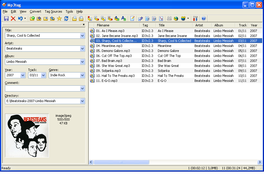

You can go in and rename files as, say 01.Trackname instead of just Trackname, which will get them displaying properly, but that might be something of a faff. Maybe an email to the developer of Bliss, who I've found very helpful, might yield a more elegant solution – you can contact him mp3tag.de, which also works with FLACs, and will let you go in and tag tracks as, Trackname / Totaltracks, so say 01/11, 02/11 and so on as in the example below
