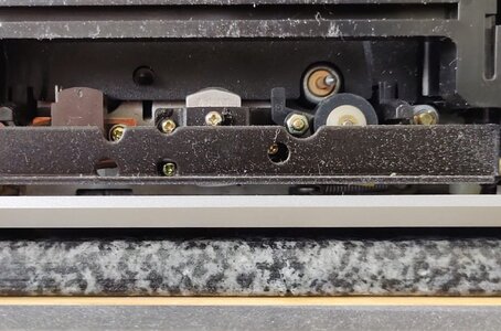

Presumably you haven't got an azimuth adjustment hole in the casework for a little Philips screwdriver - as some decks have.
Not really given it much thought, but now you mention it, is this what you are referring to?
