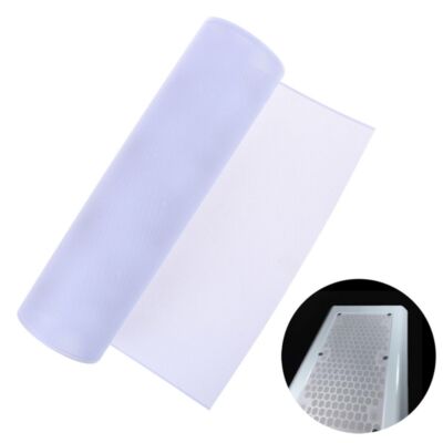

Household dust is non conductive so it shouldn't cause any problems but you could cover it when not in use, I found these first try but there must be many others.
300913703390
I'd make sure to power it off not leave it in stand by in case it overheats! All things considered I think I'd just not bother

The circuit board will be designed to handle dust and would have been tested with dust in mind.
No one here should be advising you to restrict the airflow to the amp/electronics, those vents are there for good reason, you do so at your own risk.
Those pc filters, they are designed for actively cooled systems they will drastically heat up your amp as they do a PC when they’re installed. If your amp gets particularly hot they may also melt. As they don’t actually sit over direct heat within a pc, they probably won’t but it’s something to bear in mind.
If you keep on top of cleaning the amp will be fine.
If it’s gets to what you consider bad, take the lid off and blow away the dust using compressed air (when the item is cool) and use some isopropyl alcohol and toothbrush to clean the board.
Again you do this at your own risk stay away from the power supply it can and will kill you if touched in the wrong way.
You have to be mindful also, if it’s a new product you can void the warranty by taking the lid off with some brands. And you’ll most certainly void the warranty covering the vents by doing anything other than what’s directed in the manual
