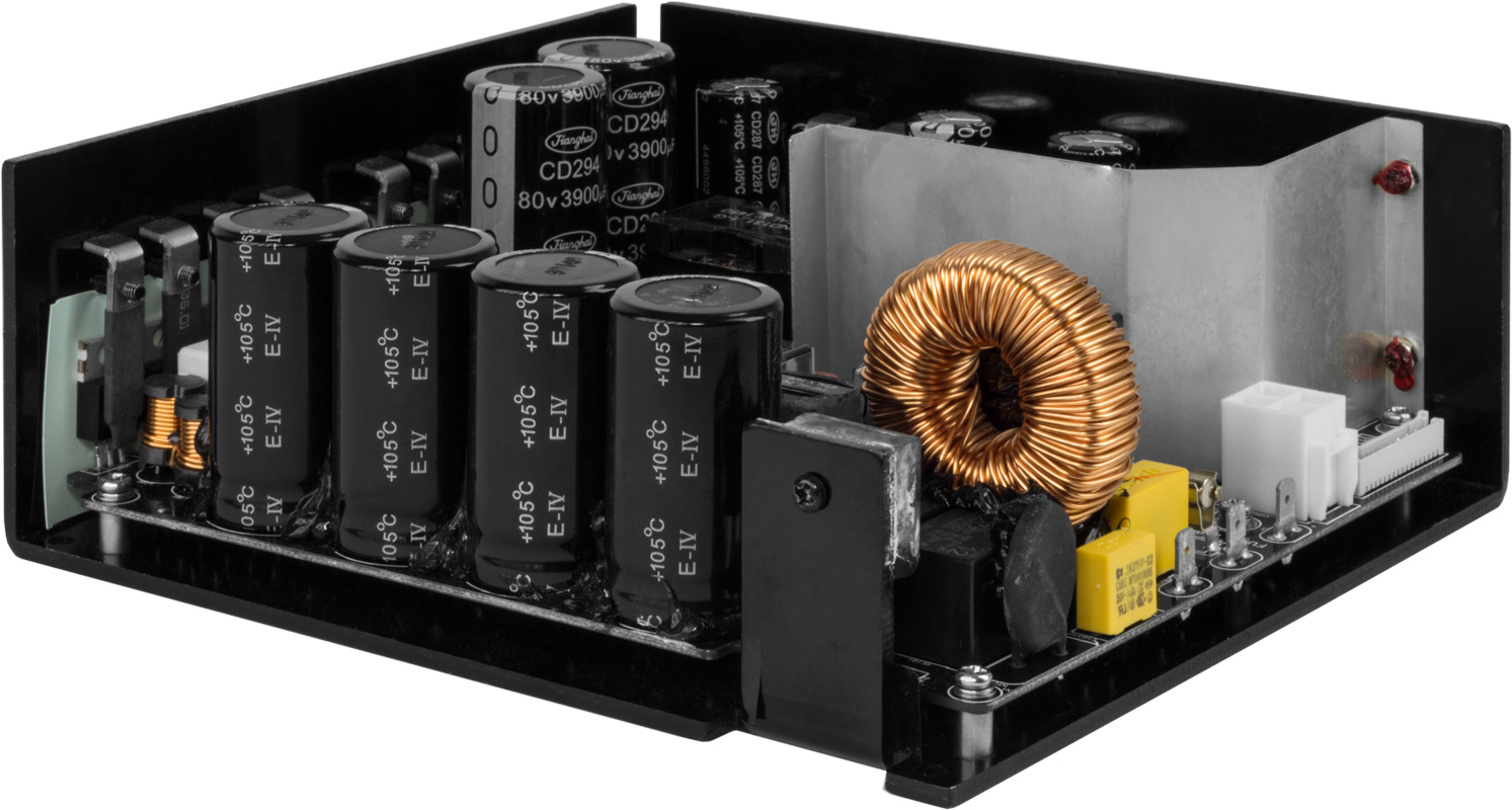

Power stage

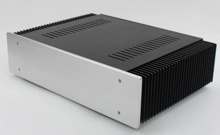

Anaview AMS1000-2600. Likely would use two modules bridged. If only using one module specs are 2x170Wpc (into 8 Ohms), 2x300Wpc (into 4), 2x500Wpc (into 2). Fun begins when used briged 580Wpc (into 8 Ohms), 900Wpc (into 4). Modules without a case are around £350 delivered . Would need a case another £50.

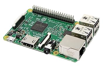

Considering a RasPi working as a Roon endpoint. Hardwired to LAN.That's about £50 wouldn't need a case as it would all go into one.
