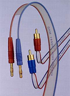

There won't be capacitance issue if he runs the two channels in separately shielded cables. If wires run alongside eachother they build up capacitance (like two plates in a capacitor).
You can just buy a standard RCA cable and just split it in half down its length and every 5 inches add some improvized separators. Example 1.5 inch foam blocks held by electricians tape.
Effectively getting this.
Will have capacitance, think of it as a long cylinder formed by the shield, surrounding the conducter. The dielectric between the two will define the inductance which simply increases as the size of the capacitor increases. The longer the cable, the bigger the capacitor. Vlad, what you say might be correct for unshielded cable but not shielded coax.
