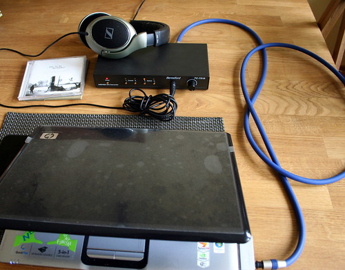

I am clutching at straws, but you said...However if I unplug the DAC it disappears...
...so the setup now is identical to mine, yet hisses, even switched off, but plugged in...

By the way fr0g, it's nice to see I'm not the only person who has left the protective plastic film on the lid of their laptop... 🙂
sensei_russ:By the way fr0g, it's nice to see I'm not the only person who has left the protective plastic film on the lid of their laptop... 🙂
LOL!
It will be off soon.. Its a cheap new laptop because (crying as I say it) I smacked the screen of my lovely XPS laptop and a replacement, fitted was around £500!! So I bought a new one, and have the Dell as a desktop with an external screen upstairs...
