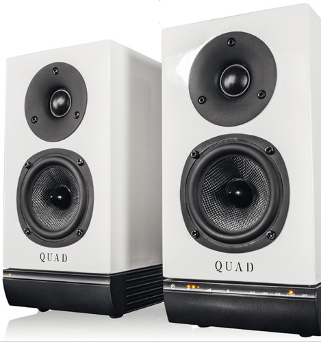

nopiano said:
This is making me scratch my head now... So active relates to the presence of crossovers customised to the drivers, and splitting the signal such that each amp/channel directly feeds one speaker?
At it's simplest ...
... all - or parts - of this can be housed inside the speaker cabinets. Wherever you 'draw' the dotted lines representing the speaker cabinets on that picture, it will still be active.
Such systems range from speakers like the Quad 9AS (everything, including DAC/Pre + electronic crossover + four power amps + drivers, in the cabinets) all the way to something like a Naim active system with up to three separate power amps (or six mono power amps!) + Naxo 3-way crossover + separate Ovator speakers with their passive crossovers removed.
