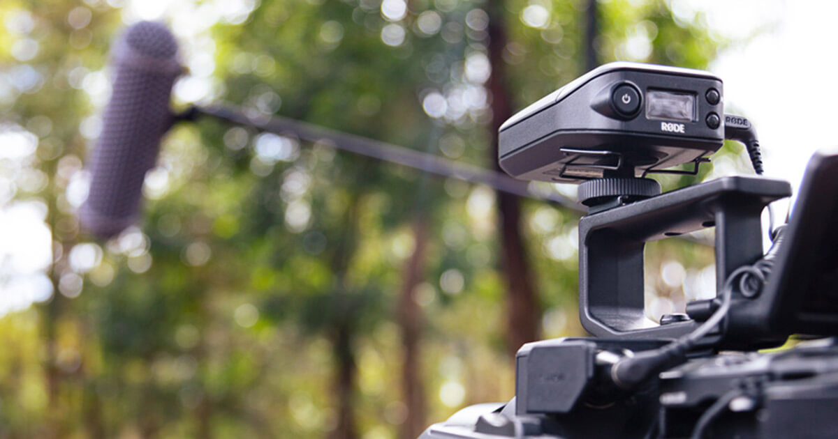

Brother told me this is what he's got:
It uses wi-fi frequencies (but not wi-fi itself).
He reckoned it may well have been superseded by now though, so it may be worth researching what's current from them and the likes of Sennheiser. (y)

Thanks for that really appreciate it.
that looks like a nice bit of kit and I know Rode are right up there with the best stuff, unfortunately a little out of my budget at the mo.

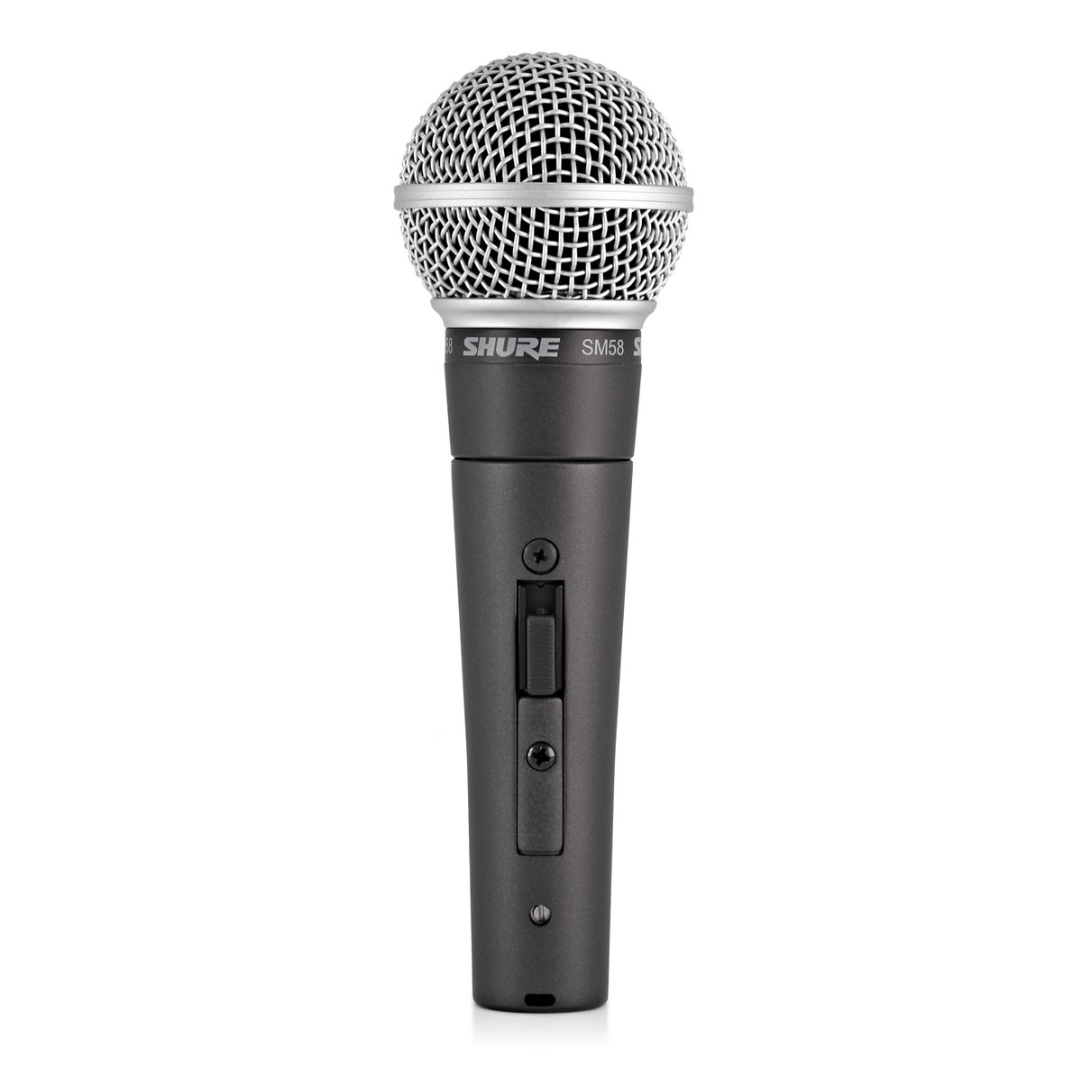

also I was looking at this microphone, it says it is designed for vocal use so not sure if it would do what I need and pick up music well?

I can't comment on the TX/RX, but the good reviews must say something.
The SM58 is legendary - anyone that hasn't used one, has certainly seen and heard them in action.
Their frequency response has a presence boost to enhance vocals - for your purposes it may be worth looking at mics with a flatter response.
Ok yes that makes sense.
The frequency response of the Sm58 is 50-15,000 Hz
What sort of frequency response should I be looking for? Something that goes up to 20,000?
Gray
Scroll down and look at the frequency response plot of the SM58:
The (darker) trace shows the sensitivity of the mic at different frequencies.
What you're interested in is how and where the trace deviates from that 0dB central horizontal line - because you can see how the mic will sound.
Notice that at around 5kHz, it's 5dB more sensitive than it is at all other frequencies. That's significant and deliberate - to give more clarity to vocals (and why vocalists like the mic so much).
If you were to use it to mic up instruments / PA speakers, you'd get clarity, but you would be favouring the sounds in the boosted regions.
When I say check out mics with a 'flat' response, I mean ones where the trace looks flatter - closer to the 0dB flat line - ideally, equally sensitive to all frequencies.
Now checkout the FR plot for the Rode NT1 as an example.......which I just did and even that is 5dB up at around 11-12kHz so likely have a more prominent treble.
See if you can do better (at the right price ;)).
