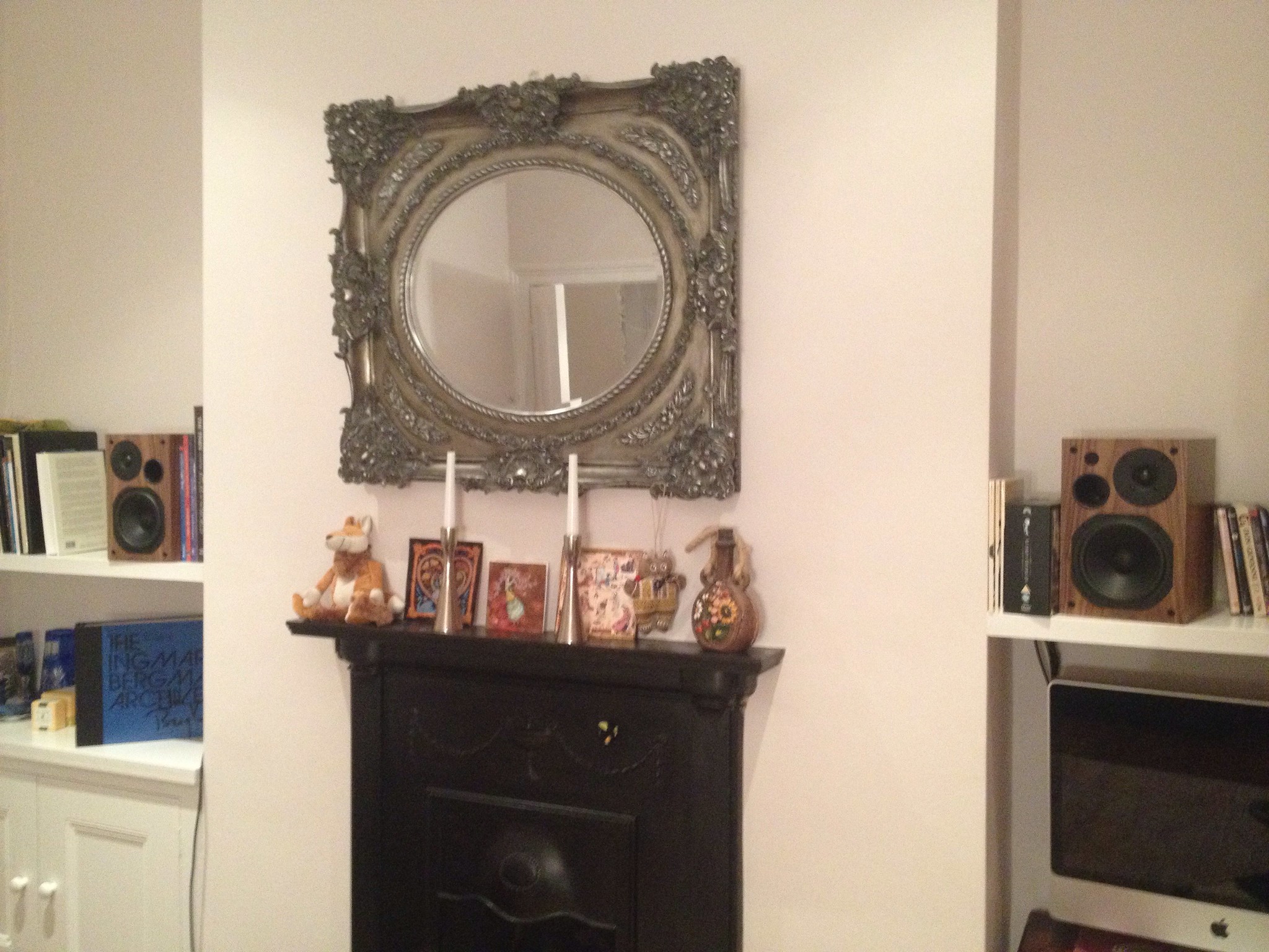

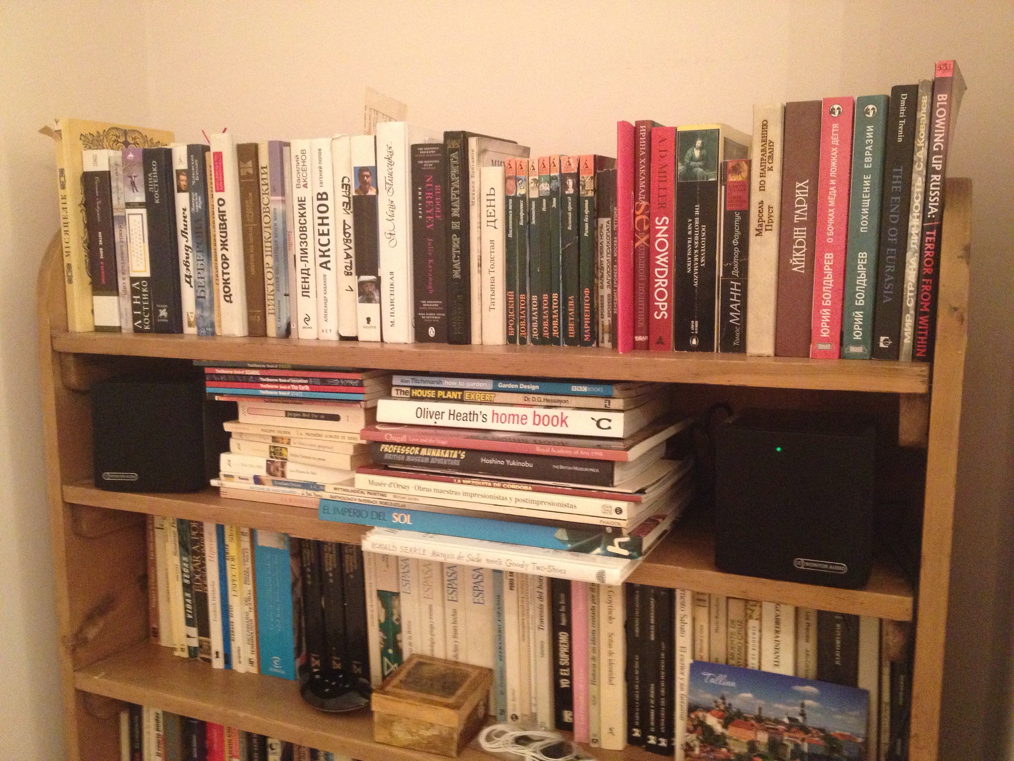

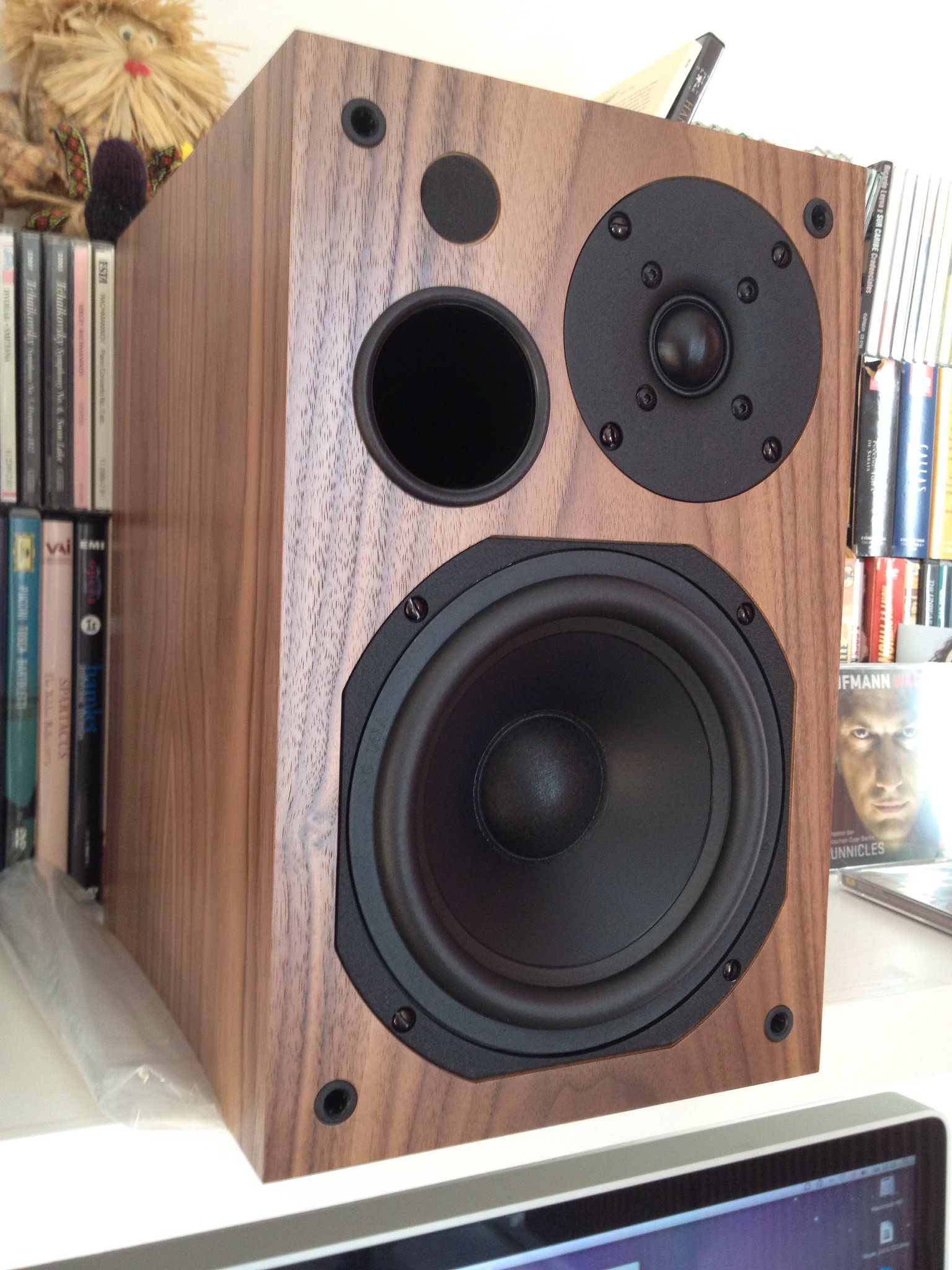

A pair of walnut ADM9RS has arrived this week to join the rest of the boxes, so we headed to Wimbledon to our friends' place for installation - a 5 zones Airplay multi-room system with actives in four zones and a pair of old Bose in the (unlucky) kitchen.
Here is the pile of gear through the unpacking.
First thing though was the back-up - which she hasn't been doing. So I convinced her she had to rectify this asap so she bought a TimeCapsule. That was good, as I was also hoping this would make all the airplay setup easier and more stable.
I have installed the TimeCapsule in place of BT Hub which worked fine. The back up took abt 1.5 hours - which we spent unpacking all the other stuff, drinking coffee and catching up on things.
The original plan was to use a combination of wireless and homeplug ethernet, but as soon as I connected the homeplugs problems started. So I ditched them and tried wifi only - this worked like a dream and, fingers crossed, seems stable.
One of the rooms:
Study:
Bedroom:
Kitchen:
And the main room:
AEXs and all the cables are hidden as much as possible so the only things you see are the speakers. They have never used Multiroom or Airplay and were absolutely delighted with what it does. They have been equally delighted with the sound, the 9s in particular, and kept saying the word 'clarity'. I of cause threw a demo of great tracks to take the new system through its paces and they loved it to bits. They were literally mesmerised with some tracks.
