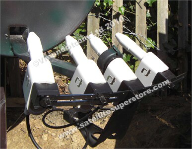

Cheaper way than a motorised dish is a multi arm set up where you have a bar with 3 or 4 LNB's on it all positioned so as to receive signals from different satellites.
Provided you have a receiver with DISCEQ ability then you should be fine.
The latest trend seems to be narrow feed LNB's to help isolate the different signals as seen above.
