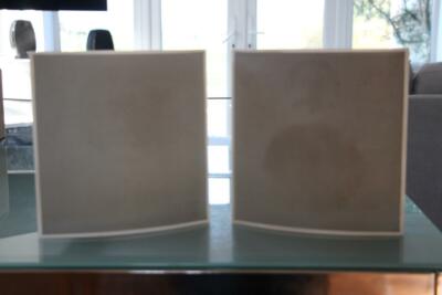

The most obvious difference to a more conventional placement will simply be that the image emerges from above you. So, unless you listen in unusual venues you will need a leap of imagination to hear a conventional stage impression. (My concert attendances tend to be orchestral or piano recitals, so I’m either at roughly stage level in the stalls, or looking down from a tier or balcony). However, if you mostly listen to studio created music there is no original to recreate as it’s all the producers imagination.
Most of the usual requirements about toeing in, for example, still apply. I’ve a pal with a super little system in his kitchen and his speakers beam down from the corners. They are Linn speakers, like these, no longer made.
