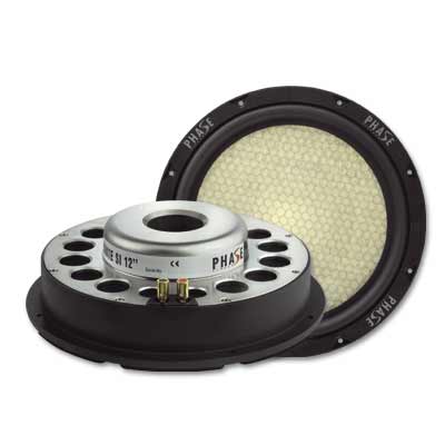

You probably mean the Falstaff by Alto: it actually is a car-audio woofer and is indeed very shallow. It is based on the Aliante-design however from Phase Linear (also known as Phase Evolution): I own one, a 12" beautiful piece of technology!
Back on-topic: topicstarter, if you are able and willing to make a DIY-enclosure with an amplifier-module built-in (which isn't that hard by the way!) you will be able to make one less than 10cm in depth. The 12"-models perform well in an enclosure of about 30Litres sealed, but ported designs are also possible.
