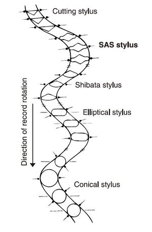

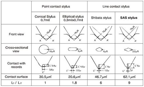

Don't go above an elliptical stylus, as the more expensive shapes require really precise setup, and the Dual Arm is not flexible enough to take advantage of them.
