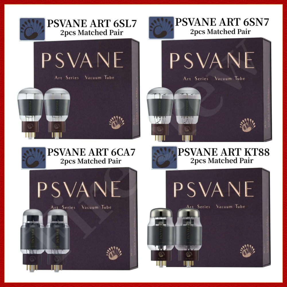

If tube rolling is something you might consider and you don't wish to narrow your options. I would suggest purchasing 6SL7 to 6N2 adapter converter for XDUOO TA-66. There are various adapters that allow you to use different tubes with the same voltage.
I replaced the original 6N2 with
PSVANE 6SL7 Vacuum Tube Art Series.
This tube is incredibly silent, I was getting very slight tube buzz with the 6N2 but this cured it completely.
It also brought noticeable improvement to the sound,
The original TA-66 tubes 6N2 (preamp) and 6N5P (buffer) are already good. Sometimes tube rolling doesn't always bring the desired outcome, not necessarily better but different, different tonality etc. Certain tubes have certain characteristics with the sound, Mullard tubes can sound lush and if you have a forward sounding speakers, this could tame them.
Potentially this could be a rabbit hole. I wouldn't rush into it, get as much info before you embark into the world of tube rolling.
The original buffer tube 6N5P, I swapped these for Sortek/Svetlana post war classic 6AS7s J wing. This was directly pin and voltage compatible tube, and adapter wasn't required.
The generic tubes on the TA-66 are already very good, so you may not to need to change them right away but the option is there when you decide to 🙂
