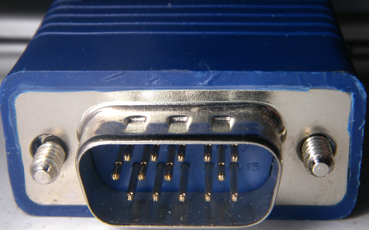

The back of your TV probably looks a little like this:
The D-Sub connnector will most likely be labelled PC and will look like the blue port on the right at the bottom. Your PC should have exactly the same port. To connect the two, you need what''s generally just called a VGA cable which has this type of connection at both ends:
Note, this will only carry picture, not sound. If you want sound, most likely, your PC will either have standard RCA phono outputs or a 3.5mm line out socket (depending on your soundcard). This could be hooked up direct to your TV's audio input socket or to the amp.
