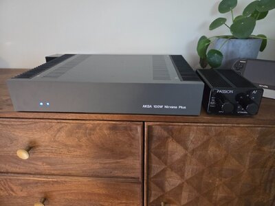

After speaking with my uncle who we just celebrated his 80th birthday, I let him know what I was doing with his old beloved Abbey Road speakers and he was chuffed.
He asked me what Amp I was running it with, and he instantly recoiled and said an AKSA Nirvana Plus he built with a Passion Pre-amp would be much better suited.

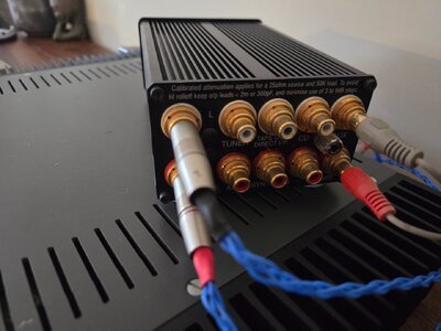

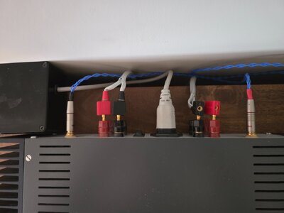

So I have set them all up and thought I would share some pictures with you all.
The only issue I currently have is that my only option to get source music is from an Aux cable running to my Laptop which is not the best feed for this lovely system.
Any suggestions what I can look to connect to the Passion AV unit to ideally stream some lossless audio?

Yes they do look brilliant in black! makes them look slightly less retro.
Yes Passion AV is a preamp with limited connections and sound control.
Well I have basically got all this kit for free, apart from the 1k spent on repairing upgrading them.
So in terms of a streamer spend, I can look anywhere up to 2k - I do not need it to really do anything else as I will have nothing else connecting to it, don't need a huge amount of bells and whistles just want it to sound good with what I currently have,
