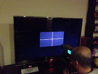

Curious to know about this calibration, I requested the local certified ISF technician to calibrate my TV. They came to my house last Sunday 31st March to perform this calibration on my 3.5 years old LED TV. This would be the first time a calibration is done on an 'old-ish' TV.
The whole calibration session took about 3 hours but that includes friendly chats and also listening to my 2 channel hifi 🙂
Anyhow, they came with 3 basic equipments:
1. Chroma Meter
He was kind enough to explain a few things about the imaging standards using laymen's term. A few points that I think very important are:

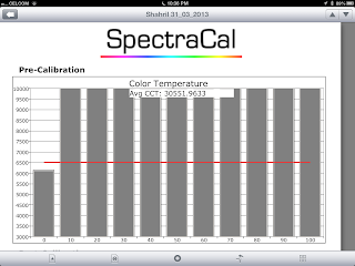

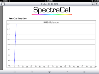

They went through several test patterns on the BD and with his computer, took snapshots from the Chroma Meter and the software processes the data. A pre-calibration status of my TV is displayed below. I chose to show the simplest information which was the RGB and Temperature distribution.

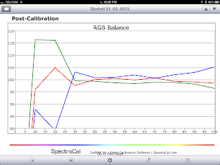

As you can see from these 2 plots, I have been 'enjoying' good BD imaging with blue as the dominant colour while Red and Green are either way off the scale or non existence. And I was also 'enjoying' a very warm image as the temperature across the spectrum was up to and even beyond 10000 deg Kelvin. The threshold for ISF standard is at about 6500 deg Kelvin.

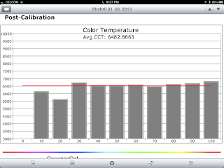

To cut the story short, the following are the post-calibration plots. As you can, the RGB balance is there and the temperature profile is at average 6500 deg Kelvin across the spectrum.

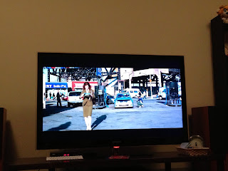

So, who cares about plots right? The results post calibration....is very very outstanding. As when I about to give up hope on my TV, this calibration injected a new life to it. Colours are more natural, night scene provides the feeling to audience that it was actually shot at night, and dullness is no longer there. The imaging is maintains the vividness and liveliness pre calibration but does not give that glaring, fatiguing effect on the eyes. Playing Star Wars Episode 1, the scene in the desert, I can actually see the separation at the horizon between the desert and the sky in which pre calibration, this was not visible.
I am not a good photographer nor do I have a sophisticated camera, so its a bit hard to show the difference but this is one calibration that one should try if your TV experience is as dull as the movie Vanilla Sky. Even ASTRO B.yond benefitted from this calibration.
That night alone I watched Star Wars and Life of Pi back to back....and no sign of fatigue nor dullness.

You would have been getting eye strain as the contrast was set too high - simple as that. High contrast ups the light output and hurst your eyes
Greyscale is a measurement all the shades of grey the tv produces from black to white - if you do not have the greyscale correctly calibrated (done with white balance) then the image will be blurred by comparison to how sharp and crisp it can be.
It doesnt affect colour at all - not directly anyway - changing the colour balances can affect the grey scale though.
Your RGB balance measures how accuartely the set is producing each primary colour at the each grey scale gradient level - the ideal is for them to all be the same at the corretct level
Colour is measured sepeartely - prmimary and secondary and calibrated seperately

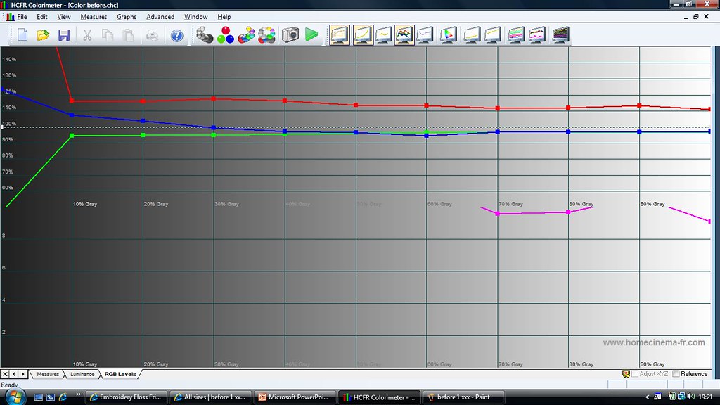

Here was my Greyscale tracking using factory default
As you can see there is a serious oversaturation in the RED but after calibration
The Greyscale is now tracking at almost the target D65 with minor errors showing in the red and blue under 20IRE but these errors are more likely showing due to the meter and there are no visable errors to the eye.
