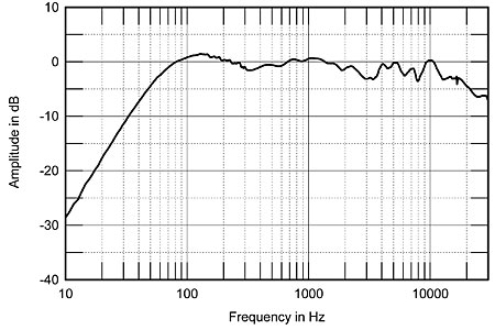

Bellow is the measurement of the 11s from the Stereophile review with some comments by John Atkinson.
"Moving higher in frequency, the woofer is well behaved in its passband before crossing over to the tweeter close to the specified 2.8kHz. The tweeter is also well behaved, though its top octave is plateaued down by 3dB compared with the region between 4 and 11kHz.
As usual with a 1" soft-dome tweeter used in a fairly wide baffle, the radiation pattern becomes more directional above 8kHz or so. Along with the shelved-down top octave, the ATC will sound a little mellow, even lacking in air, in rooms of medium to large size, or in small rooms with too many absorptive furnishings."

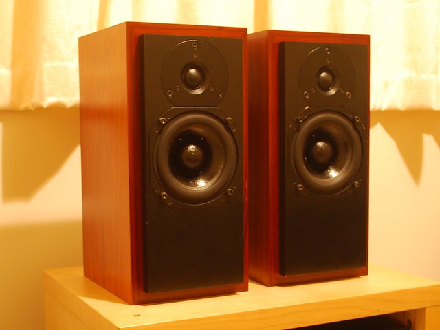

See if you can find some SCM10's. They use the Mid-Bass from the SCM7 but with a much smoother Tweeter and is slightly bigger than the SCM11. They do them in Rosewood too 8)
They usually go for around £300.
My old pair-
