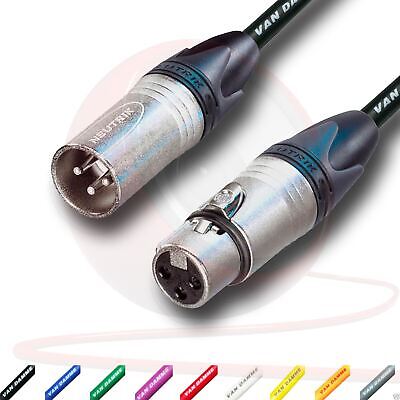

I would make use of the XLR.
You (or someone you know) can easily make your own, highest quality leads - using Neutrik connectors and Van Damme Starquad cable.
The colour you want.
The length you want.
And all for well under £20.
EDIT
Or, let these people do the making for you:
You could pay (a lot) more for XLR leads, if it makes you feel better. I wouldn't.
