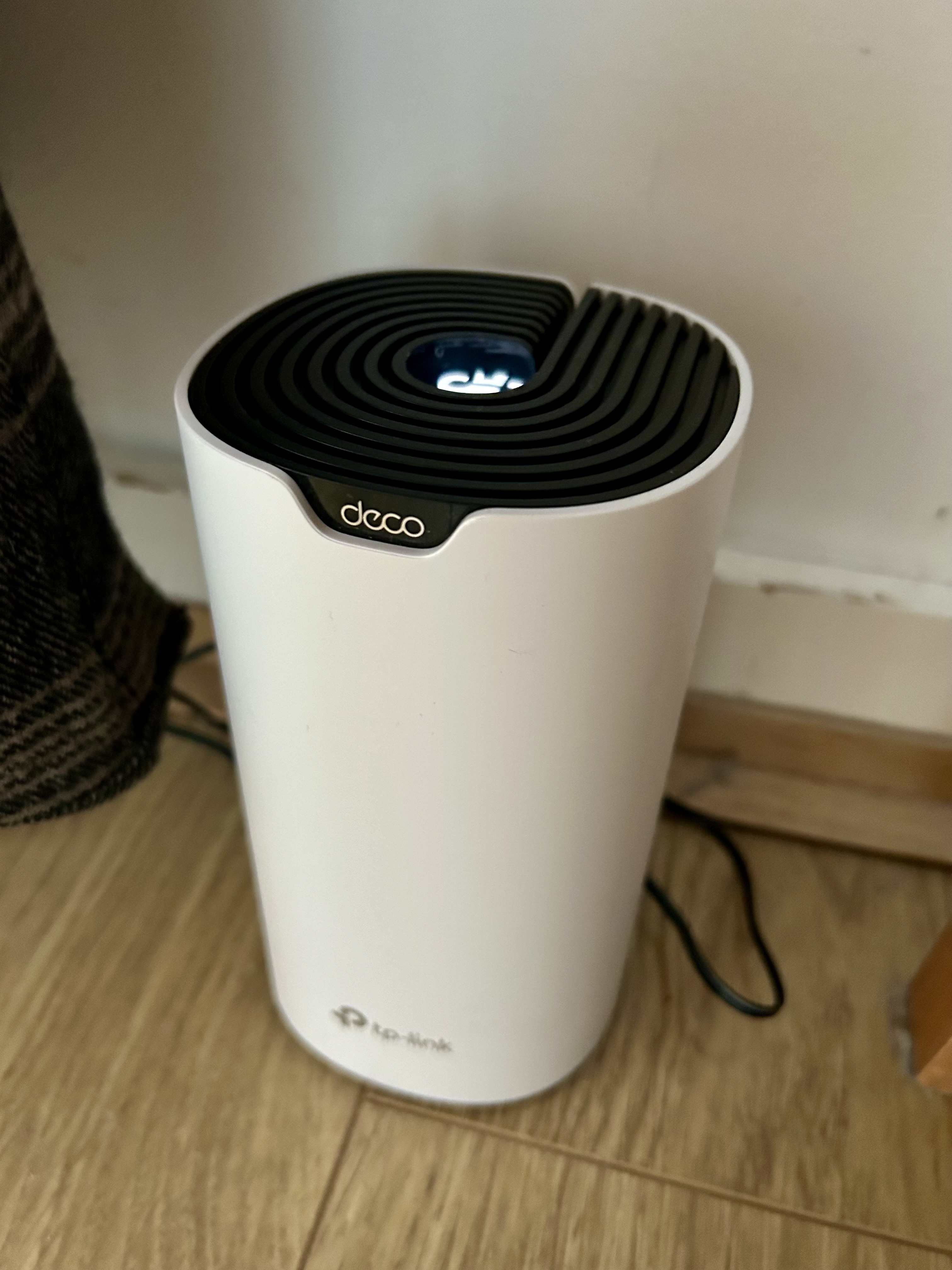

Update: I’m all meshed up in the flat & got full speed WiFi in the bedroom. The Bose Soundtouch is finally working properly, & not requiring a restart every five minutes to reconnect 🤩
Massive shout out to @DCarmi for your help & advice.
I went with an £80 twin pack from Amazon. Buying on the cheap end has given me units with an unfortunate look of travel kettle about them. But one is tucked away behind a monitor & this one in the bedroom is hiding under a chair for now.
