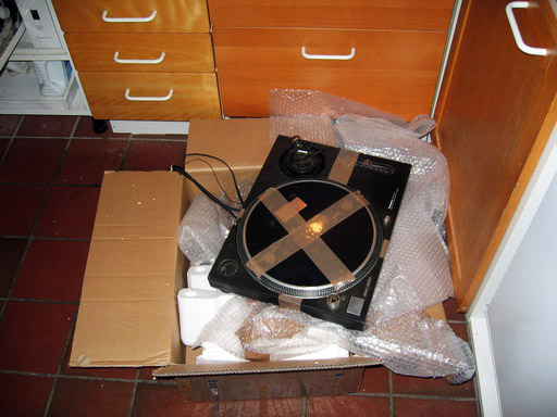

Here's that Technics restoration project I mentioned earlier. Whether or not this is too 'bling' depends on one's personal taste (it's a little too bling for me!), this is an astonishing effort and a stunning piece of workmanship ultimately. How to take an utter car crash of a deck and customise it into something that is a real headturner.
It goes from this:-
to this:-
and this is has all the steps in between and how the guy did it:-
http://www.12x0.de/index.php?forum-showposts-214
