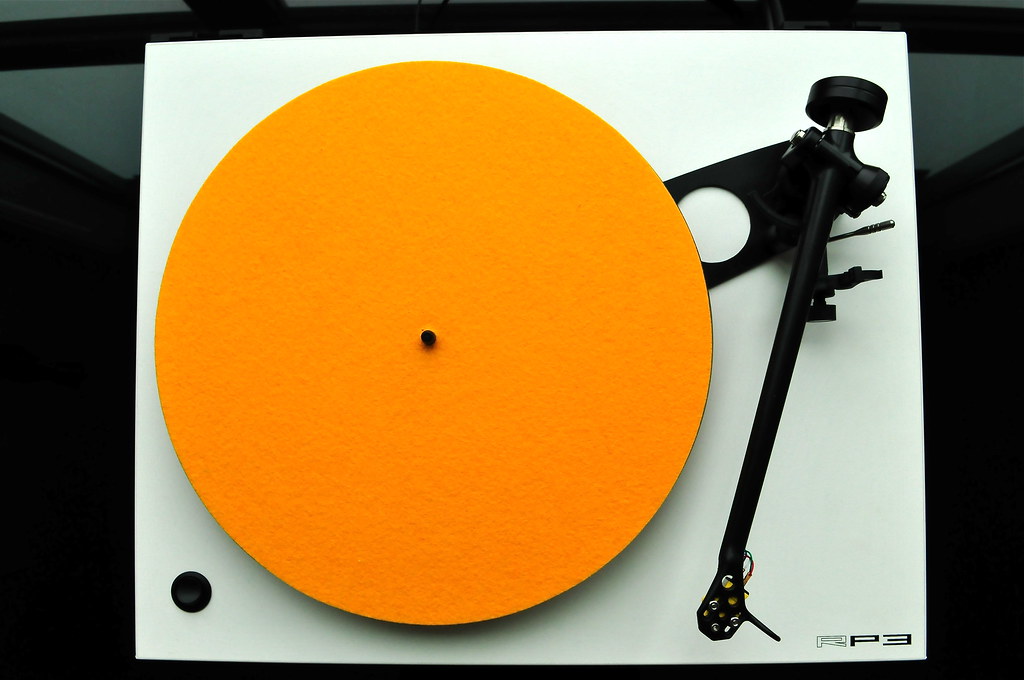

If you want to do yellow turntables and speakers correctly then try these ...
s_134200173084949-extra-large.aspx
Oops! Mustn't forget the yellow felt mat ...
