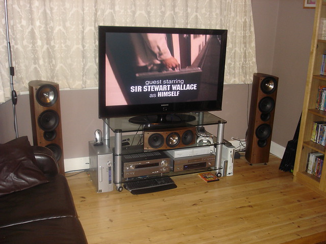

Right this is how it did look originaly with the Plaz set in the window Bay(this is a old pic and most of the equipment has changed since)

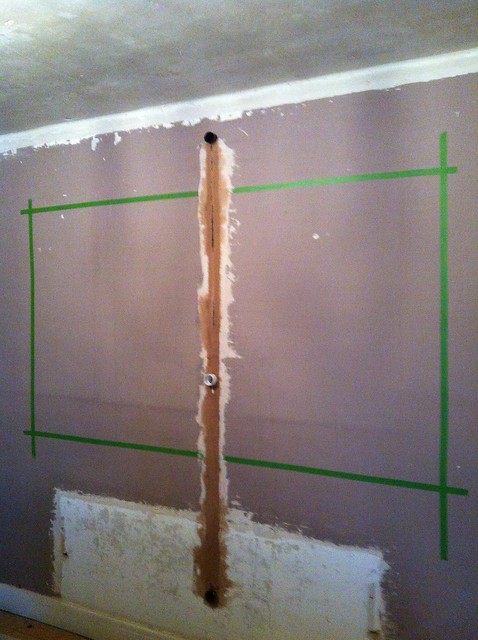

In the next pic you can see where I've marked out the rough size of the screen but that Radiator is going to have to go!
Next the rad has gone and I've channeled a cable path into the wall to hide all cables and make it easy to change any cables in the future.

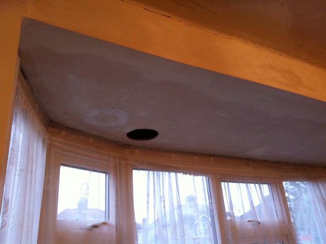

HDMI and speaker cables were run to the PJ end of the room and I planed to install speakers into the celing at the PJ end to neaten things up rather than use my current KEF iQ3's on stands for the rear channels so time to cut some holes!

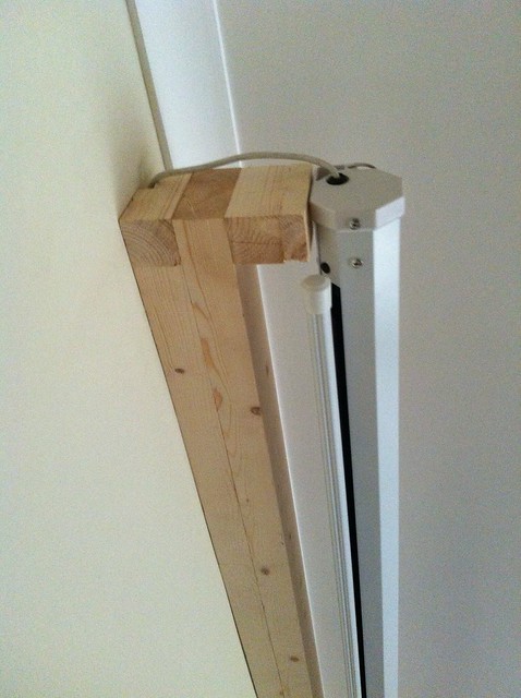

A few coats of paint later it was time to start instaling the Equipment!first I wall mounted the Plaz so that I could measure how far the Plaz came out from the wall so I could make a mount for the screen so it would clear the plaz and also hide the electrics for the screen.
