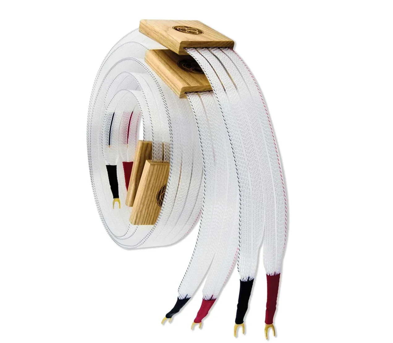

If OP looking for cables the faux Nordost Valhalla 2 cables from AliExpress are mighty fine! 🎯
ein Paar V2 HiFi-Lautsprecherkabel, Hupenkabel - AliExpress 44
Smarter Shopping, Better Living! Aliexpress.coma.aliexpress.com
