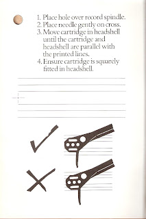

If your cart is set up using the Rega 3 bolt alignment, then it is worth getting the Baerwald alignment tool from Vinyl engine, going to two bolts and trying that. It may or may not resolve the problem, If it does then it saves you loosing money on a new cart, if not, then you have wasted 30 minutes.

http://www.vinylengine.com/cartridge-alignment-protractors.shtml (Ensure you follow instructions to the letter to ensure accuracy.)
I had a great time trying out both Baerwald (for Rega) and Stevenson alignments back in 2008 when I had my Rega P2 and upgraded from a pre fitted Rega Bias to an Ortofon 2M.
I remember trying both 'geometries' for a couple of days each and then reverting to the Stevenson set up eventually. (Still slightly different to the results you get just using Rega's own single point alignment tool.)
Rega's own, supplied, alignment card results in more distortion - at the end of a side - than when using the Stevenson alignment protractor from Vinyl Engine.
