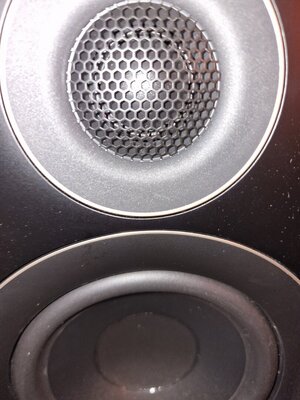

Purchased the Prodigy 1 speakers in February of this year. They have been excellent, doing everything that I wanted them to do ,great soundstage, excellent bass and super mids and highs,so all good.
Switched my system off the other night after about a 3 hour session all fine.
Switched the system on next evening sound sounded flat with no highs,on checking,both tweeters were providing no sound. Visual check and as I hope you can see from enclosed pictures,absolutely no damage . I have 2 amp systems so tried them on other system with exactly the same results . Contacted PMC but they just referred me to distributor as on warranty. My question is has anyone else had any problems with these speakers, I am sure I will get comments that they have been overdriven, can only say not as far as I am aware,smallish room so no need for power. I believe some speakers are fitted with fuses is this a possibility.Can a tweeter be blown without any damage to the cone ,bearing in mind this has happened to both speakers. Due to my location in Spain sending speakers back for repair is a nightmare and if I could confirm what caused the problem would be happy to buy 2 replacements when over in UK for Christmas. Has anyone replaced one of these tweeters, is it easy, looking forward to any constructive comments
Thanks
Drivers can sometimes just fail, but it'd be extremely unusual for both tweeters to just stop working.
I know that the obvious reason would be that they were overdriven, but they were working fine until I switched them off. Just trying to workout if it's possible that the crossover failed. Is there some safety fuse fitted which failed when system switched on,I know it's highly unlikely, it would happen to both but it has,and no visible signs to cones,I'm perplexed .I would just like to understand what has happened, if I have to pay for new parts,that's fine😟

So am I. Some sort of arcing or DC signal would be the reason two tweeters blow simultaneously. To be fair to PMC it doesn’t frankly sound like a manufacturing defect on the face of it. That said, they charge premium prices and probably want to retain goodwill, so might well fix them fre of charge through their local distributor or provide spares for you.
But I’d remove the switching box and see if you can test it, otherwise you’ll soon have two sets with blown tweeters!

to be fair the only thing I find odd in this set-up is the use of a remote speaker switch and feel sure this is probably the culprit. Haven't heard of any issues from people using these speakers in a 'normal' set-up.
As nopiano says (and what I was going to suggest), plug the Prodigys direct into the amp and see if they work properly.
I am fortunate to have 2 systems,have connected them direct to my other amp,exactly the same problem. The switching unit connected to my Vincent only uses 12volt supply,completely solid state to speaker connections. While I can't rule it out will be surprised if it is the issue 🤷 . Have sent a mail to pmc,to ask if I could communicate with one of there tech guys. If it's something I am responsible for, will happily pay for the repairs. Just don't want a repercussion after they are fixed.
You don't hear a clicking relay as it switches then?
While it's disconnected from the speakers, if you've got a voltmeter, you could check the outputs as you switch it.
Of course it shouldn't be the issue, but we wouldn't be surprised if it was.

....and I do have to more than double the volume knob to get reasonable listening levels. Matt the technical support engineersuggested that the tweeters may have been overdriven
I think Matt could be right
Ultrasonics that you can't hear, but that the tweeters really didn't like - at high levels.

That’s a good point, as the gain with MC cartridges is enormous and any HF oscillation or spurious output will give tweeters are hard time.
That said, I’m still inclined to think there was a surge or spike given that both PMC tweeters blew simultaneously.
