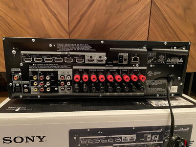

I should have been more specific.
I was wondering whether they could add a picture of their specific wiring to ensure everything was connected correctly. I seem to recall another post also mentioning other issues so I wondered whether everything was connected correctly. 😊
Assuming they're all hooked up correctly, I'm going with an issue in the software within the amp. A long shot, as you'd expect an issue like that to be replicated through more than just one amp.
