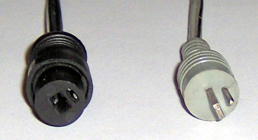

For speakers you will need cables terminated (at the B&O end) with male DIN 'spade and pin' connectors ...
(male connector on right)
At the speaker terminals you can usually use bare wire. (Just take care to get the polarity right.)
