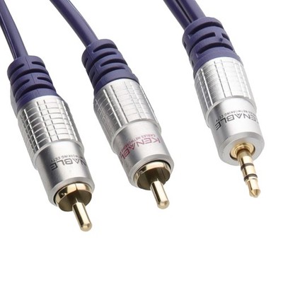

I've done some puzzling and see there's 1 bit missing.
My PC has an S/PDIF output that I could put in the optical input of the V-DAC.
The only output option on the V-DAC is a 2-way RCA mini jack.
I do not have a cable in the house that turns 2 female RCA into 1 mini jack for the KEF aux input.
Is it worthwhile buying such a cable, or won't it add extra sound quality - perhaps even make it less good with the mini jack aux?
All the cables that came with the V-DAC are high quality copper by the looks of it. Ending up that chain with an ordinary mini jack also might weaken the signal?

Differences between DACs can be subtle - but a million times less subtle than the differences between cables (y)
For under 3 quid, this (perfectly adequate) cable would allow you to experiment if you wish to.
Various lengths available:
Reactions: Ludo

Thank you again Gray, I've meanwhile bought a similar gold plated cable.
Afterwards I decided to hook up the V-DAC to the laptop again, because on the main desktop it's not so practical that I always have to remember to unplug the power to prevent it from overheating.
The laptop is used only occasionally, and set up so that unplugging won't be forgotten.
Also, the KEF-egg sounds really good enough on its own - it was a worthwhile experiment :)
