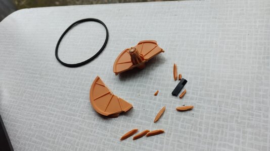

I currently have a Panasonic PMX800, which I've had for a few years. I like the sound quality and how quiet it usually is.
However, recently the disc drive sometimes doesn't open.
I spoke with a long time friend who is an electronics repair technician, and he said I probably won't be able to repair it due to lack of available parts.

Doesn't seem like my friend will be able to fix it.
I can take it to a local repair shop, but they charge to even inspect it.
Do you know what could be causing the tray not to open? If I lightly hit the side of it, it works again.

Does he know what you said about hitting it?
It could be a loose-fitting PCB connector feeding the tray motor.
If I was your friend, I'd be opening it up for you - to at least have a look. Sometimes causes of trouble are as obvious as when my Philips drawer wouldn't open....
There was no hitting that back into action 😆
(There will be nothing that big inside your mini system).

Opened up the PMX800 today. Cleaned it out and I'm replacing the belt.
