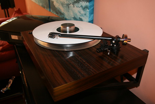

and here's what it looks like now...
The result is absolutley stunning! The build quality is excellent - it is now a substantially heavier beast - it really feels like a much more expensive machine, and is exactly what I was after when I started the search.
The complete turntable that I now have has:
50mm birch ply plinth with lacquered mocassar ebony veneer
23mm acrylic platter
Acrylic Acri Mat
Inspire HiFi puck
Acrylic cone feet
Origin Live counterweight
From my P3-24: sub-platter, RB301 arm
Goldring 1042 cartridge
TT-PSU power supply. (played via Trichord Dino/+ and rest as per profile)
Robert also refitted the lid hinges, so my existing lid fitted back perfectly.
(a note if you already have a Rega wall bracket: ask Robert to put the feet in the original Rega positions, as Inspire prefer wider positioning for the feet)
After refitting the counterweight and sorting the downforce (I've gone for 1.75g to start, using a cheap ortofon balance), I was ready to play.
With all settings (volume etc) the same as with the P3-24 before the makeover, I played the records that I was most familiar with from previous playing:

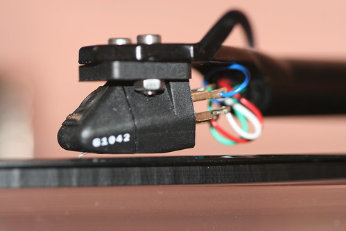

As a fellow Goldring 1042 man, I'd be very interested in seeing how low yours tracks. Mine, is no more than 1 - 1.5mm off the vinyl. It sounds great but had it checked out by an expert over the weekend and was told everything was in order, and that the 1042 does track lower than most cartridges.
Mine is same distance above vinyl (no more than a mm). Sounds damn fine. Here's a pic ...
