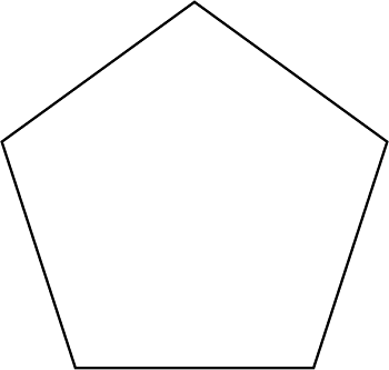

In a flat that I rent in the last decade, I hade the chance to have a pentagonic living room. The room accoustic was amazing. If you know a little bit about room accoustic, it's evident why.
