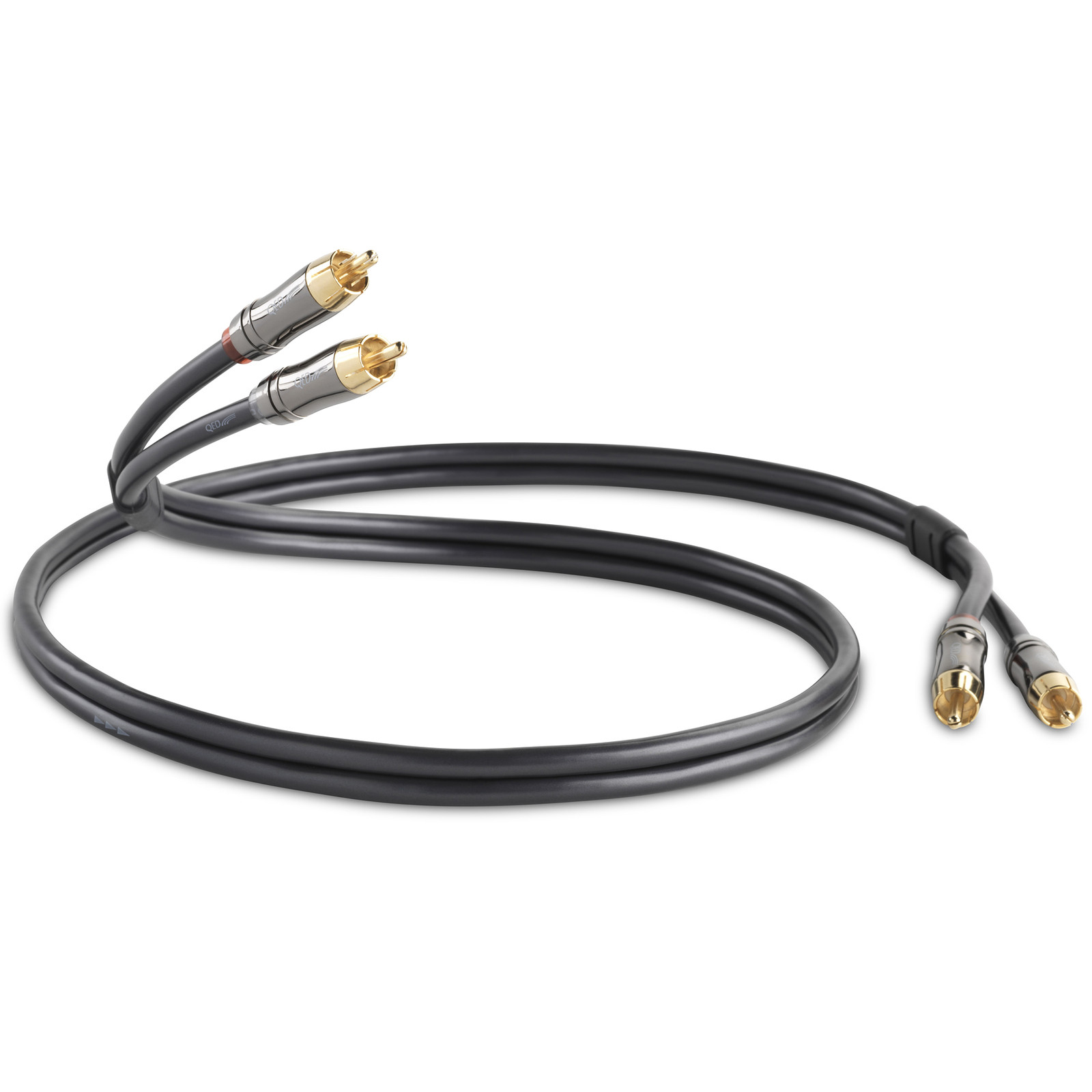

Thank you James for taking time and explaining me in detail what is what. Is that mean I only need one RCA interconnect cable to connect poweramps to Integrated? like this one from picture below?Correct me if I'm wrong. Many thanks.Stan.

Cables are fine, just so that you can split them to separate power amplifiers. Might do better with two individual phono cables, just for positioning really, no other reason.

Yeah just like that Stan ,
