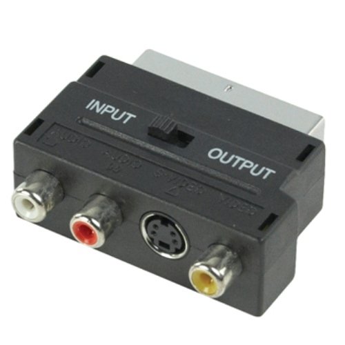

If the TV only has an Optical out, then a scart adapter should do the trick to get analogue audio from the TV (most TVs have at least one scart port that doubles as an output)
Though i think PP needs to clarify, exactly how everything's connected (ie which outputs are connected to which inputs of each bit of kit)
as the op is confusing...
