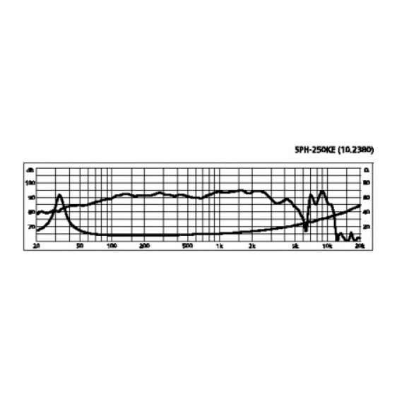

@ Frank: Point duly noted :) I will post the frequency responses later and you can see what you think, but to us it looks ok, I have just ordered some plastic subs for those Acoustic Research Rock Partners that I was asking about a while ago on here (remember, wedge shaped?) so we can try those in these instead of the kevlar and see, why not. They are the same size,
Won't be changing the crossovers I dont think, the sensitivities are close enough too, 90db on bass and 88db on mids, LF crossover is at 3K. My only slight thing is that these bass kevlars begin dropping off after 2.6K - I can live with that. They are 10" and start at 20Hz.
Here hoops:
Mid
http://www.bluearan.co.uk/index.php?id=MON102590&browsemode=category
(Look at the size of the magnet on that lol)
Woofer
http://www.bluearan.co.uk/index.php?id=MON102380&browsemode=category
