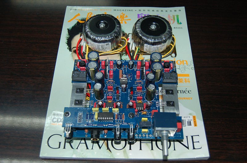

See the picture for the insides of the Little Dot MK V Dual-Mono Headphone Amplifier. Cool or what?
