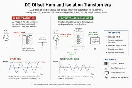

45+ years and 15+ amps and never had any DC hum
Poor design with cheap transformers Chinese Quality Control
Had a UK made 8000A for several years with no Hum back in the 1980s
Recording Studios use Isolation Transformers to cure DC
There’s so much wrong in the above.
Firstly Chinese quality is often far better than Western QC. I had some Italian made Moka pots, three from different manufacturers fell apart when spot welds failed. Two German ones are well made. The two Chinese ones are far better designed, far better made, and far better finished. The German ones look rough in comparison with welds clearly visible. I have numerous Chinese hand torches, they are beautifully made, CNC machined from aluminium and stainless steel. I had a Chord Mojo, claims to be made in England, it fell apart after a couple of years, £400 down the drain, junk. iPhones and iPads are Chinese made and high quality.
There’s a chap here saying that his mid 1980s made AudioLab 8000A has always had mains hum:
DC hum is due to the main supply having a DC offset, mine sometimes has it, sometimes not. It can arise due to appliances in your house, or even in neighbouring buildings. There’s reports of hum from many different brands of amplifier. The AudioLab 6000A does seem to be noted for it. It’s a British designed amp with the company owned by China.
There are comments online that a DC offset is caused by switching power supplies, and these are becoming more common. I am not an electrical engineer, so I cannot comment.
