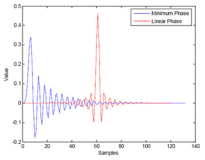

but don't forget that oversampling and digital filtering introduces ringing to the signal. so yes, you've got Nyquist frequency moved further up the spectrum, but at the same the signal does not maintain the ultimate fidelity.

not quite right. oversampling makes the DAC has lover noise floor and also aliasing artifacts go higher up the freq spectrum. still any DAC will create aliasing artifacts at half of sampling frequency, i.e. for 96kHz signal aliasing will appear at 48kHz - way above human hearing threshold. for Red Book it'll be only 22kHz so just outside audible spectrum which makes it quite tricky to create the right filters. low pass is better but it'll have to start to attenuate within audio range. there's no such problems with oversampling. oversampling DACs will have a ruler flat freq response as an effect. but oversampling also introduces ringing of the outputted signal and that's a completely different story. check this picture below. maybe it'll tell you more than my words.
