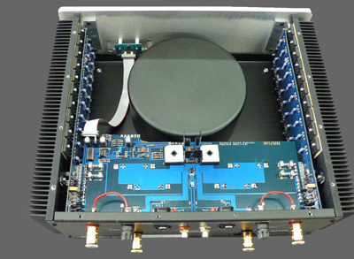

This. Sells for £3.5K in the UK. Designed for use with ESLs. I'm getting one on loan tomorrow.

Ahh, the Magtech, lovely.......!
Stereo or Monos?

I think stereo will be fine for my room and listening habits. The monos are for crazy meatheads, no?
It'll be interesting to compare it to the Devialet. I have mixed feelings about this. The Devialet is a thing of beauty, but the Magtech (or similar) would make more sense in the new house. If the Magtech wins, it gets to run the Montis in the living room, and the Dev can go into service with the Cremonas (now SAM-ready) in my den. Result.
