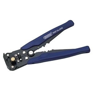

me too but you can get a pair of "proper" stripping pliers clicky if you do it a lot. They allow you to set the cable size to get the best effect
Even better, google "automatic wire stripper" for a tool that automatically sets the guage of the wire, looks like this...I've have something like this for years, been a god send
Agreed. One of the other benefits of this type is that you strip the exact amount without stretching the sheath. So you don't end up having to do it again
