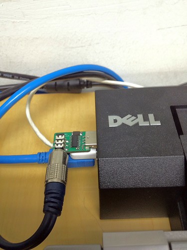

I am currently using a DIY USB DAC based on the ES9023 Sabre DAC and it only cost me GBP 25. Just wondering if I will get a much more SQ with that amount of money.

Nevertheless, what makes the dragonfly also a headphone amplifier and my DAC not? The DAC shown in my first posting also can easily drive heaphones and IEM but the volume is of course controlled from the laptop. Does the Dragonfly have its own volume control as it says on the website 'variable output'
The Dragonfly does have it's own volume control on the device itself but I think this works similar to the HRT Headstreamer in that it effects the software volume and then in turn changes the analogue volume on the device itself (not digitally).
What do you have your DAC plugged in to in the photo? Do you plug headphones directly into it?
What is the make and model on your DAC and where did you buy it from?

he says it a home made one with a ecc sabre dac in it in the first post.
It's plugged in to a dell laptop dock by the looks of things.

OK fair enough. If the Dragonfly has a analog volume control, then maybe it can be categorised as a headphone amp too.
My DAC is a ES9023 Sabre DAC, directly plugged into a Dell laptop USB port. The 3.5 mm output jack is then connected to a Bose Companion SII speakers. However, I also use it sometimes to drive Shure and Sennheiser IEMs and also Bose and Alessandro Headphones with no issue. For the Bose speakers, I set the laptop/iTunes volume to the max and just control the volume manually on the Bose speakers. For headphones/IEMs, I set the volume on iTunes to the max and control the volume on the laptop.
Its a DIY product by a friend and he is selling it for about GBP 25 equivalent.
Sorry for the silly questions before, I forgot you mentioned that stuff in your first post. The speakers you mention are active and thus have their own amp anyway, but to drive the headphones you mentioned it must have some kind of amplification. It sounds ridiculously cheap for what it is.
Do you know how the sound compares to off-the-shelf (so to speak) DAC/amps?

No worries mate. I would not say the Bose speakers are active...its just a powered speakers. Yes, it is cheap hence the posting on whether a 215 quid USB DAC will give much more SQ or not.
As for the question on comparison, I wrote a review of this DAC on another forum. Copy and psate as below:

From the picture above, you know why I call this unit a ‘Naked’ USB DAC. Its physically a clean and bare piece of USB DAC. Main components being the USB, the DAC and the 3.5 mm jack.
The DAC used here is an ES9023 Sabre DAC. Its commercially available and it’s basically a 24 bit stereo audio DAC with an integrated 2Vrms op-amp driver. For more information on the ESS websitehttp://www.esstech.com/PDF/ES9023%20PB%20Rev%200.2aPB%20110117.pdf
