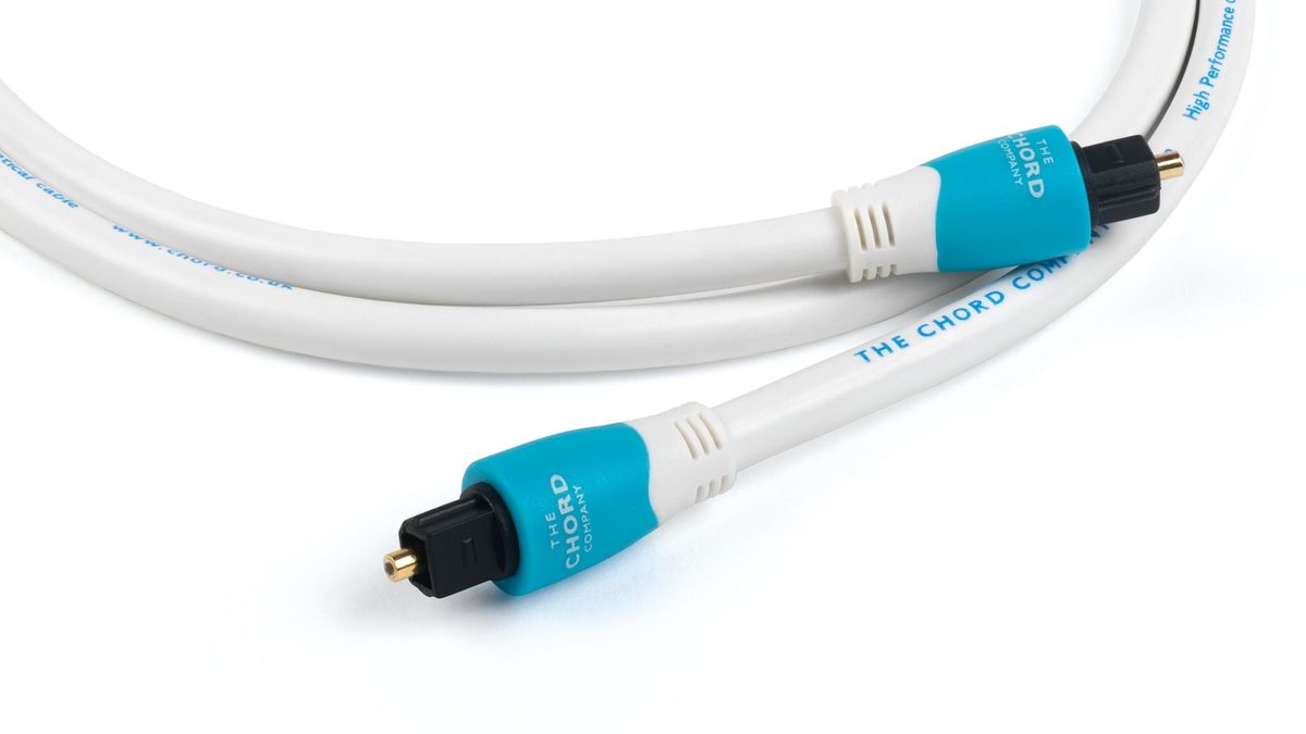

Hi
I’m using Bluesound node2i to stream music directly to the Audiolab 6000a connected by optical.
When I play a certified MQA 192khz album on bluesound or tidal app the Audiolab only show 96khz is being played.
Per my understanding, using optical cable on my bluesound is to let the amplifier DAC make the work and the Audiolab 6000a DAC is surely able to handle 192khz but for some reason it is limited to 96khz , how can I fully enjoy MQA file 192khz is there a setting to turn on somewhere ?

My understanding is that the DAC in the Audiolab (very capable though it is) is not MQA-certified and is unable to 'unfold' the MQA encoding. If you use an analogue connection between the Node and the amp, the DAC in the Node will do the unfolding and you will benefit from whatever additional quality the MQA format brings. Then it becomes a choice between which sounds better to you - non-MQA using the Audiolab DAC, and MQA using the Node's DAC.
thanks a lot ! Very clear and i guess it solved my problem.
i just ordered a Chord company C-line RCA cable to connect the Node to the amp. Let see which DAC sounds better to me now.

Ok so i tried both optical and RCA analog cable connected from the Node 2 to my Audiolab 6000A and i'm disappointed to not hear any difference.
When i using optical, the audiolab is showing me the audio quality (96kHz max even if the file is 192kHz ) so i expected to see 192kHz show on the amplifier when using RCA since it is the only way to let the DAC of the Node unfold it, but unfortunately there is no info displayed.
Do you know if it is normal that the audio quality is not displayed when using RCA cable?
I start to believe that the whole story about DAC quality and cable quality is pure illusion.

In regards to the Audiolab's display, this is very normal - in fact, it's expected. For every amplifier. RCA in this case carries an analogue signal, and analogue does not have sample rates and bit depths.
When you're connecting with optical, the Audiolab is doing the conversion, so the signal going in is digital, which does have sample rates and bit depths that is then converted to analogue inside the amp. It can see that information, so is therefore able to display it.

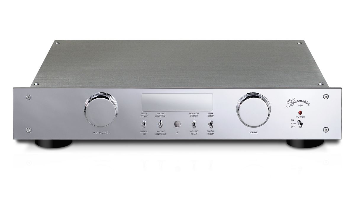

Say it's-a-time-effort, Premier League is equivalent to Hi-Res Audio. Will the addition of a player always significantly change a club's performance? May be the-club excels only in the First Division.
And consider this:
"What we need are audio components that are capable of delivering High-Resolution Audio. For example, the D/A converter (DAC) built into the typical DVD player usually has a "24-bit" DAC that only delivers a 90 to 95 dB SNR. This is the equivalent of 15 to 16 bits (CD performance at best).
But, an outboard DAC is only a partial solution to the High-Resolution Audio dilemma. A second key part of the problem is the performance of the audio power amplifier. A 24-bit audio system is useless if it passes through the typical power amplifier. It is nearly impossible to find power amplifiers that can deliver an SNR higher than about 102 dB. This is the equivalent of 17 bits (adequate for CD applications, but definitely not adequate for High-Resolution Audio). Anyone who thinks they can hear the difference between 16-bit and 24-bit digital audio through a "17-bit" power amplifier is fooling themselves."
And yesterday, I was reminded that WHF's current hi-fi reference system [has] a £36,150 pre/power:

I neither agree nor disagree with that opinion from John Siau, it’s just a viewpoint to explore. What you would’ve read if you had linked through:
In contrast, the Benchmark DAC2 outboard DAC has an SNR of 126 dB (equivalent to 21 bits). The DAC2 is actually capable of delivering peaks that are 3.5 dB higher, giving the DAC2 a total SNR of 129.5 dB (21.5 bits)...
For this reason, Benchmark has undertaken the difficult task of building a power amplifier that is worthy of the title "High-Resolution". The new Benchmark AHB2 power amplifier has a 130 dB SN.
