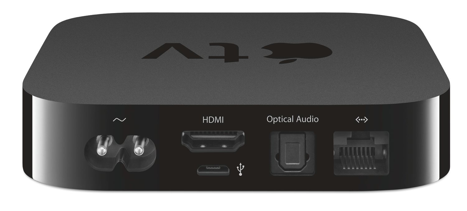

Depends which Apple TV it is. Does it look like this:
or this:

It's the latest Apple TV (the one with 1080 rather than 720), the event uses an iPad in a locked case on a Kensington chain, and we were just using a 3.5mm jack from headphone socket into Bose but last time the 3.5mm jack got bent through rough handling so I want a wireless solution from iPad to Bose and as I already have the Apple TV it seemed like the obvious solution. Maybe a DAC is the way to go or maybe a QED uPlay? I want as high a quality sound as possible. Hmmm thinking cap on again :)
