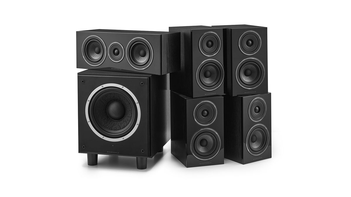

I’ve been running-in the Wharfedale Diamond 12.1 on behalf of my brother-in-law
Its sound is starting to really come right—and its to-my-taste. I’m thinking of owning my own pair—and of course, also imagining stacking
Happily, a so-called Home Cinema Pack is available i.e.:
Such AV bundles make it easy to try D'Appolito…
