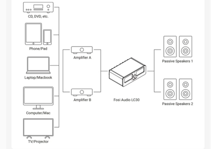

Could I be impertinent and ask why you need to connect two amplifiers to one pair of speakers?
At least I assume this is what you intend to do.
It wasn't clear how you actually connect them.
That is what i intend to do .I have 2 setups with 2 Amps, one is stereo2.1 with the 7000n the other is AV with a sound bar 5.1 via the 70S .
This will allow me to use my B&W speakers for AV has well has they are connected to the 7000N.
The 70s also has 2 games consoles plugged into it via HDMI.
A hybrid setup i guess.I dont have the space for a full AV setup oh not to forget the DVD player Apple TV & theTV is also connected to the 70s.
This way i get full use from both Amps.

So exactly how are the amps connected to that switch?

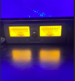

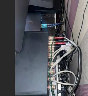

Arrived late this evening glad i prepared ahead .Looks and feels better than the pictures seems very well made nice to use the feel of the switches feel nice not plastic feeling.
Works perfectly cant hear any abnormal noise.
I can now use both Amp at the flick of a switch.
The power source is via USB handy if your running out of power sockets.
You can also use it with the VU meters off.
